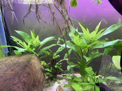

The problem was all my hygros stopped growing, got symptoms of severe K difference, Mn/Mg/Fe like symptoms, N symptoms, and all the old leaves fell off over a few days, some of the new leaves and the middle ones seemed to be ok but a bit holey. Nothing wanted to grow.

I know for sure the good large poly is def doing better with less, the holes stop appearing in the newer leaves at the lower dose and the colour seems ok, maybe slightly yellow in new growth, but does go green eventually as it gets older.
The cory was my best plant, it is now a mere fraction of the size it was, 90% lost and still looking sick.

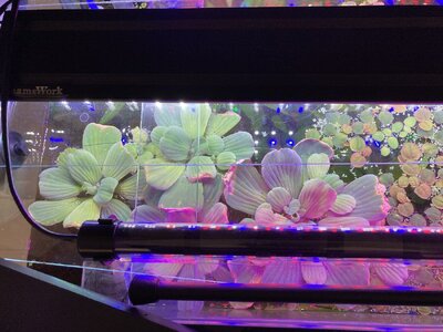

The water spangles have gone to crap within a week and a half of reducing the micros, but the rooted plants are still showing signs of toxicity. The spangles show all new growth to have square patches in a grid pattern that are white and some are tuning into holes. Older leaves are ok and the original plant looks great except a new leaf is forming with the same white squares.

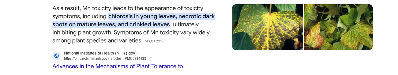

I have always suspected it's Mn that is causing the majority of the issues as I have dosed inorganic micros many months ago as separate chemicals before I could find any chelated ones. And I never had issues with similar higher amounts of Zinc or Cu, I didn't have Boron as that is banned it seems, I had Mn, but as SO4, so I suspect it was quickly unavailable as was in the Equilibrium.

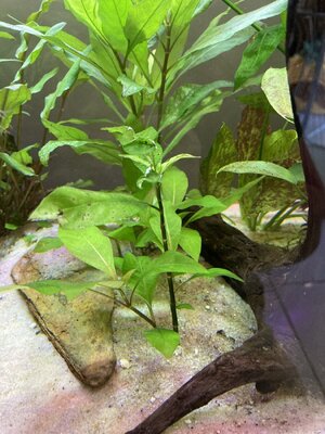

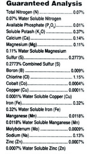

So I reckon I have figured out the problem. It's the Rexolin, or at least possibly the source of the Rexolin. Not sure what is wrong with it, it's basically toxic at all doses at a dose dependent manner where the floaters can tolerate it more than most other plants I have.
I heard one anecdotal report of a person having the same issue with Rexolin, and then sourced it from another supplier, claimed he took 2 years to figure it out but was adamant that is what the casue was, same sort of toxicity symptoms too, it was in a high tech tank though, which I would imagine would have a much larger margin for error than a low tech.
Anyway, I am still dosing the Flourish (regular one with just traces mainly) and I upped the dosing to 10mL twice weekly, so the other micros except iron were actually a bit higher than what I was doing with the Rexolin and the difference is remarkable!

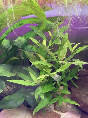

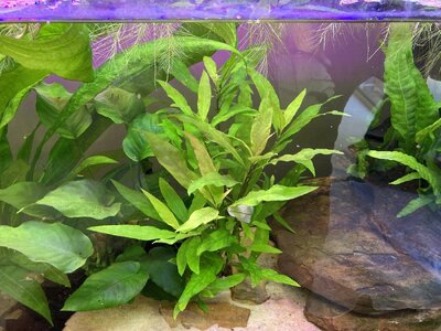

The already sick hygros on the left side of the tank are not getting any worse except when I hit a hard deficiency due to the sustained low dosing over many weeks in order to figure all this out.
So I am still waiting on a response from the sick hygos on the left of the tank, the right side is doing well with no more holes appearing, there was a bit of a yellowing/slowdown in new growth during the deficient period but now is responding to the new/old regiment.

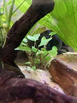

See the pics, close examination of the red root shows toxic effects on the very oldest leaves, medium age leaves from about 3 weeks ago are the deficient ones, buckled, pale and veined and smaller, the new ones are mere days to no more than a week old and they look heaps better! not all of the plants have responded yet, many have poor roots so their uptake seems to vary a lot from individual to individual.
The water spangles have exploded into growth, the older leaves even exploded into much larger sizes in just 2-3 days, but since all the damage seen here is from deficiency (never got toxicity on them, instead they are very prone to deficiency I found) and newer leaves are growing large and fast and decently healthy. I am using them to gauge the micros as they show it very clearly.
Lastly, you can see new duckweed leaves that are darker and 2-3 times the size of the old ones. The duckweed is looking great for all the new growth and the rate of surface cover is 2x the speed at least, even during the use of Rexolin, so that tells me that even though the floaters grew ok for the most part on that, the toxic effects still hindered their potential.
I'll keep this regime and post in a few weeks what I find.

These last two which I currently use are regular Flourish which worked great once I dosed enough, then Trace added with Flourish reduced so the combined dosing of the majority elements remain similar with the addition of Nickel.
First one is Trace and the last is regular Flourish.
Even though I thought that the zinc and copper were still in the very low levels in absolute dosing, it's 24 and 32x respectively the amount in flourish. This seems to be where my issues in toxicity lays.

So now I know, that trace results in toxicity, at the normal dosing, where as flourish does not at all and even requires a high does with very positive results.
The two that stand out is Zn and Cu, but Cu in other situation haven't resulted in the obvious nuking of the plants.

So here are some updated pics.
New to crypts too, neither melted which is awesome! new leaves on the smaller one already, hard to tell with the bigger one since it's so dense and busy looking.
Newly added water lettuce has bounced back from the copper treatment, even the old leaves have gone from white/yellow to a nice green! And in the last week it has suddenly stated to grow quite quickly.
You can see the red root still look very orange/pink with mottled look, but they are improving as I slowly up the daily dosing of Flourish and now Mn.
Corymbosa recovering from the brink of death.
Trimmed and replanted poly I think?
Tuesday and then today Friday, so 3 days and some speedy growth.
I figured a lot of the pinhole issues is lighting, I am always fighting to clear an area for them through the floaters, the floaters gather at that end due to the water current.
You can actually see the lighting difference in that 3 days, I cleared more today than 2 days ago.
The new ones I added on the left side of the tank (in the pics above) have had no such issues, and due to the way the floaters move, they actually have full light all of the time and are doing well, no pinholes on any of them. I never had any holes on any of the upper high light areas on this lot that is often shaded. So I am 90% sure they have a min light requirement, even in low tech tanks. When I had the Beamwork marine EA light, none of the hygros had holes, even when the leaves were aweful looking due to being new to the game and not dosing anything at all. They light a lot of light, but I am limted with this Beamswork Vivo due to lack of afforable options in Aus. You might noticed the DYI red/blue lights, they cost me about 25-30 AUD a pop to make and have boosted the much needed R/B end lost due to having so much plants up top. But they are on the weak side of lumins, better than nothing and they have certainly helped.
Really loving this, so much enjoyment in watching the ecosystem evolve and learning by problem solving.
The micros elements have been one of the hardness aspects to learn and figure out.

So interestingly, slowly upping both Flourish and additional Mn resulted in sudden issues with the floaters and the older hygros rapidly developed pin holes, even in the new growth. No other major issues, leaves are still all attached. Maybe a slight slowing of growth in the hygros and floaters.
It appears Mn is the cause of the pinhole issue, either via too much or an accumulation over time.
Zinc appears to cause chlorosis overall, death of mid and lower leaves and eventual rot of the stems and plant death as well and stunted growth and twisted bunched together new growth.
I was seeing that and the pinholes together with other ferts rich in Zn, but now for the first time I have seen a separation in the symptoms which confirms further than Zn toxicity is quite bad for the plants when it happens.
Where as the pinholes don't appear to be anywhere as devastating. Given the speed it happened and coinciding with adding more Mn than Flourish did itself is a strong correlation that it is Mn that causes that issue, not 100% on that but pretty confident.
So I think my experiment of more Mn didn't help at all, only sped up the OD on that most likely.
Googled Mn toxicity and looks pretty much like what I see, more the pinholes appearing and getting larger with time while dosing is maintained than the other symptoms mentioned, but I do see a little of that in the red root floaters.
So, I'll dial it back, and cancel the Mn supplement. I need to clean the filter anyway and I'll perform a 30% WC.
