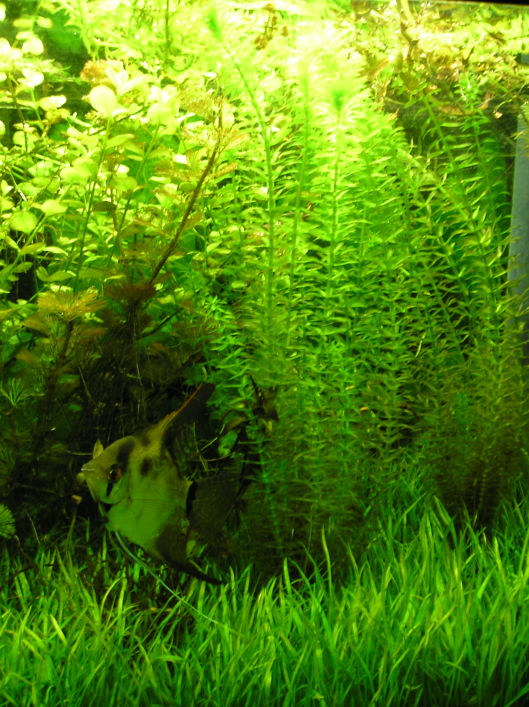

Anacharis only green for top 2"-3"
http://www.securestat.com/Aquarium Pics/Anacharis.JPG

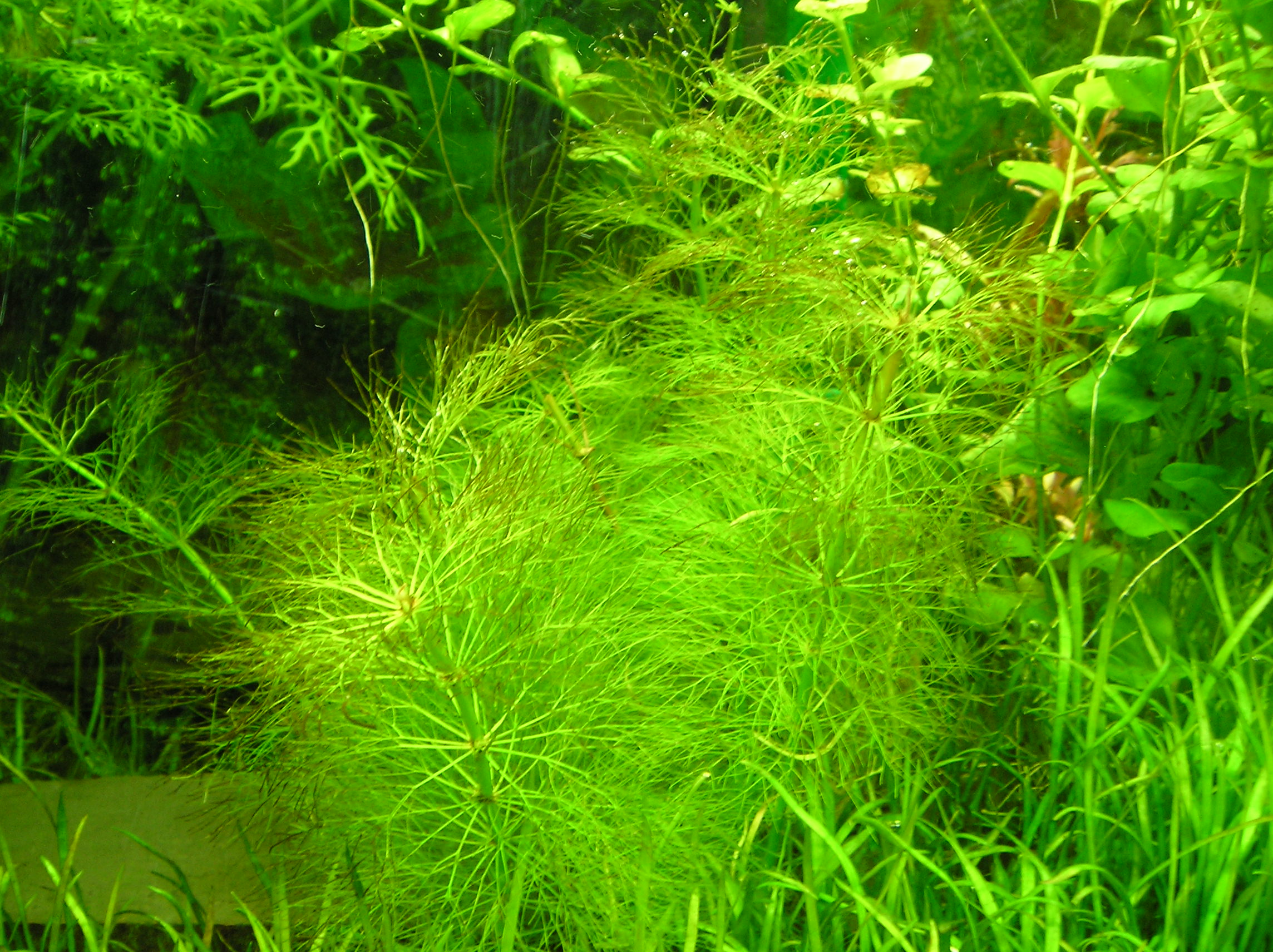

Hawthorne, ratty, no new growth since I have had it
http://www.securestat.com/Aquarium Pics/Hawthorn.JPG

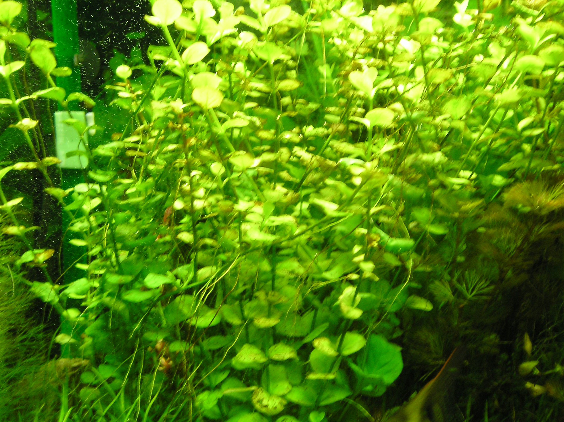

Pond Penny seems to grow but new leaves remain small
http://www.securestat.com/Aquarium Pics/PondPenny.JPG

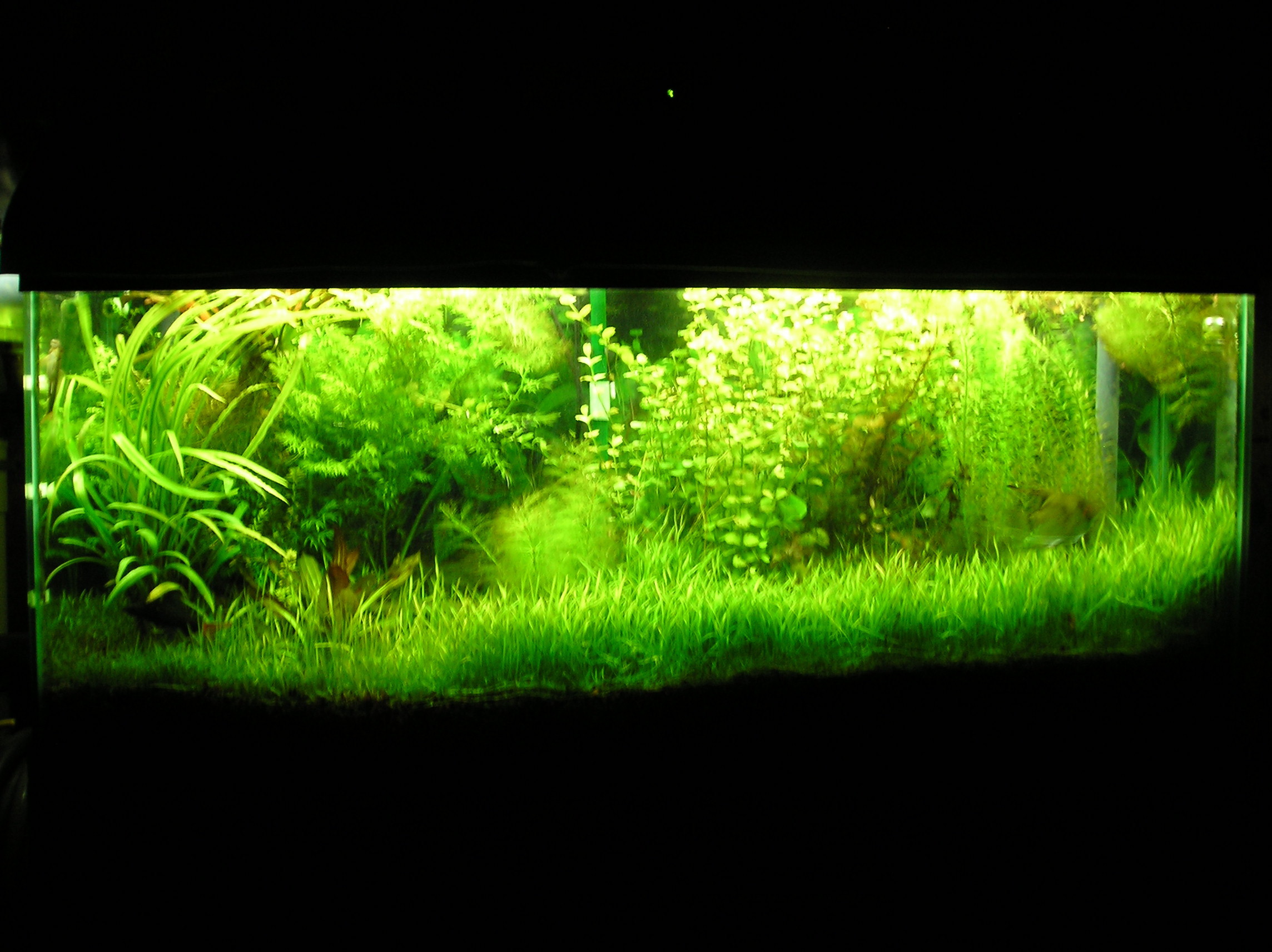

Overall tank pic, sure looks alot better from a distance
http://www.securestat.com/Aquarium Pics/Tank Overall.JPG
I'm not a great photographer but if any of you think better pics will help I will gladly try. Thanks to everyone...

What a lovely tank! :)
I know your drop checker is reading yellow, but have you tried upping the CO2 and maybe the current to carry it? You have massive light levels and you might not be adding enough CO2 to cope with that. Also, add TMG on off days, but throw in about 15ml.. I found this released the growth on quite a few of my plants almost instantly.
Just keep in mind that your driving growth like crazy with such high light (too much in my opinion) and if your short on any tiny thing, your gunna get issues.
Personally, Id knock off your midday boost lights totally, your aim should be quality growth, not lightening fast growth.. less light will allow the plants more time to absorb what they want, and allow you more time to fine tune things as the whole cycle isnt going to be going at 100 mph.

I too had a problem with the plant you called hawthorne.
It grew quickly the first week I introduced it to the tank and then nothing. That was before my excel days so that may have been an issue.
It seemed to always have some sort of brown algae on it. I'd cut it off and more would end up on it. I just pulled it out.
Hopefully you'll have more luck;-)
