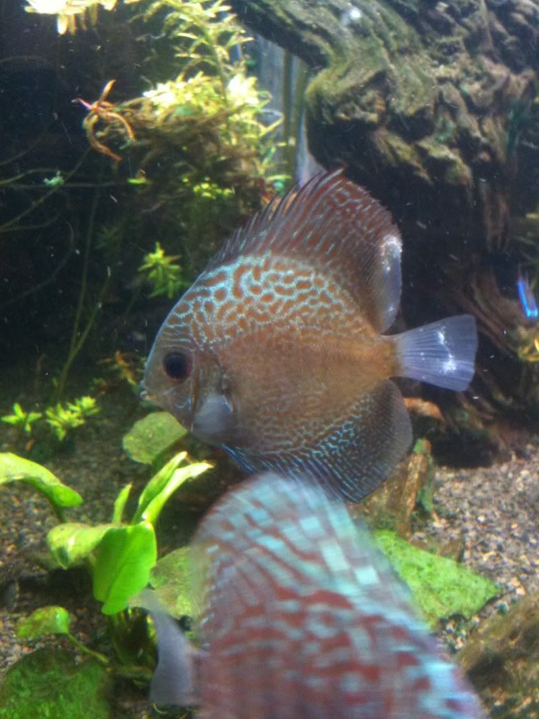

I purchased 9 discus two weeks ago and all has been well until a couple days ago. One of them started to clamp one of its fins to the side of it body and would stay away from the rest of the pack. Two days later the smallest one got a bit of white stuff on his tail. http://i1092.photobucket.com/albums/i406/CharlesCrews/photo.jpg The white stuff went away but now his body is slightly worn, like he is lacking a slime coat.
Now the majority of them are clamping a fin and look lethargic, they all still eat and will come up front when I walk to the tank but most of them have turned a much darker shade and some rest on the bottom of the tank leaning on something to keep them semi upright.
I haven't seen any poop that isn't black, and no one is chasing anyone around. A couple of the eruptions are now nearly completely black and you can barely see their pattern. No one looks like they are about to die but I certainly know they aren't healthy.
I had a bit of a BGA breakout that I have fixed with erythromycin, today was the final dosing (on a side note its completely gone). I did a full dose then the following three days I did half doses.
Having seen the down turn in all the discus's health I did a 60% water change yesterday, and added 28 tablespoons of salt today.
Water temp is 85, Ph is 6.6-6.8, Nitrite is 0, Nitrate is reading 0 but I haven't been EI dosing since I got the discus (thought I would give them sometime to get adjusted before exposing them to Nitrates).
The smallest one is just at 3 inches and the largest is a bit over 4. I have been feeding them 3 times a day, beef heart once a day, Bloodworms once and pellets once. Normally do water changes twice a week at 50%, replacing with tap with prime.
Tank is a 140gal with an fx-5 and an xp3, c02 injection with drop checker reading blueish green, I have an airstone in right now since they weren't looking very healthy its currently been running 24/7.
I was thinking about doing a dip on the discus but without knowing what the issue is its hard to tell what I should do...
I have asked around on simplydiscus but those people just hijack your thread and argue with one another or tell you you shouldnt have discus in a planted tank...
So between a salt bath, formalin bath, malachite green, formalin and malachite green, methylene blue or potassium permanganate bath what is the right option? Or should I do something completely different?

A couple of things:
Cut back the co2 to nothing. With canister filters you have a high concentration of CO2. Discus can be very co2 sensitive. That looks like a fungal infection from damage in shipping. Get peat moss from home depot. It will slowly lower the ph and is a great anti bacterial agent. Use something like pimafix for the fungal issues. Stop adding salt.

Discus will turn dark and remain not frisky when fed etc if gassed too much, with optimal O2, this is about 45 ppm.

My best guess is that the Discus pictured had some injury, happens all the time in shipping and got the mycoses as a secondary infection, Saprolegnia is pretty much everywhere and is a useful fungus.
I am with Henry and Tom Barr I suspect the other Discus fish are simply gassed…
:gw
Please, do not add salt.
With the Angelfish my best guess is the Melafix (Tea tree oil, Melaleuca alternifolia) and Pimafix (West Indian bay tree, Pimenta racemosa) may have suppressed, but did not cure the mycoses.
I really think Potassium permanganate or methylene blue bath, maybe as a last resort KANAPLEX (Kanamycin Sulfate).
  • If you are hinky about using Potassium permanganate paste, mercurochrome, iodine or povidone heavily dosed on a cloth and dabbed on the infected areas will work.
  • A 1% phenoxethol solution, 10-ml per liter of aquarium water, if necessary a second treatment after 5 days, I would not follow on any further treatments with phenoxethol for another 2 or 3 months.
