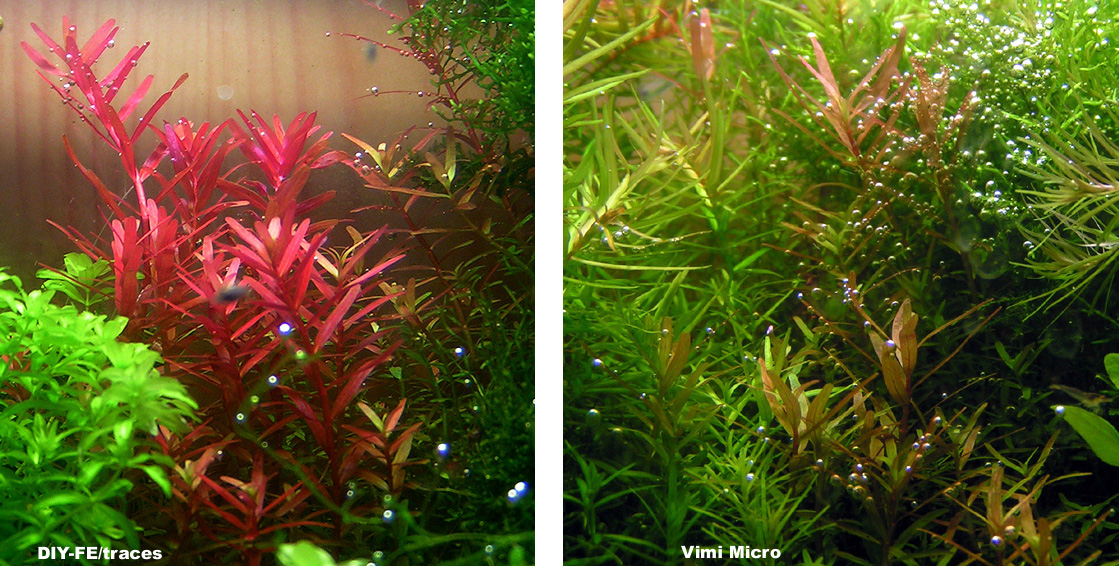

    This may be right, but there is study that compares submersed vs. emersed (water)plants. There were some differences between the Fe/Mn uptake ratios and such like zn/cu. Well unfortunatly about, B and Mb uptake I just found nothing.
    About chelators I found few comments like this:"FE-HEEDTA is a poor iron source at all pH levels because of fixation and, at high pH, substitution of calcium for iron."
    There was also an old Seachem posting about gluconate vs. EDTA:
    http://www.thekrib.com/Plants/Fertilizer/gluconate.html
    It contains some interesting statements: "The paradox, simply stated, is that EDTA can remove nutrients from solution and cause deficiency, while at the same time it can provide Fe to the plants."
    Perhaps noone mixes here his own fertiliser, but seems few ppl. on other forums do so & that they prefer to do mixes off several FE chelators and this sounds somehow smarter. It still opens again the question, what chelators should be used more and what chelators should be used less.
    Well however, I am currently also using a chelator mixture. The plants show now very vivid colours compared too my old Vimi fertiliser. (my coloratas were still looking greenish-brown before: http://www.nanoplants.de/test/colorata-x.jpg )
    As side effect, the own mixture also tinted the water a little bit (seems to have somehow a 9XXXk pinkish bulb effect on red plants)
    So I am now considering to reduce the part from those chelators who tinted the water or if I should be the things like they are or perhaps giving Seachem Purigen as addition a try.
