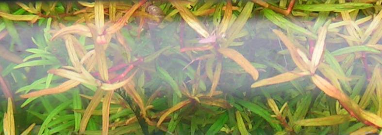

So, I finally tested it out and changed big the Ca:Mg ratio (tank had 25ppm ca and 6ppm Mg all the time)
I changed it to this values:
Ca 50 ppm
Mg 4 ppm
And this are the results:
Rotala Yao Yai:
http://www.nanoplants.de/test/yao.jpg
Plant stundet, tips died

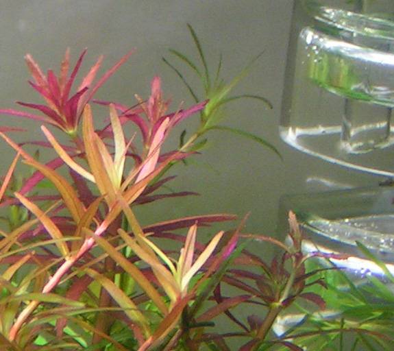

Ludwigia Super Red
http://www.nanoplants.de/test/super.jpg
Lost his red colours, looks very strange
Normally looks like this: http://nanoplants.de/plants/ludw-mini.jpg

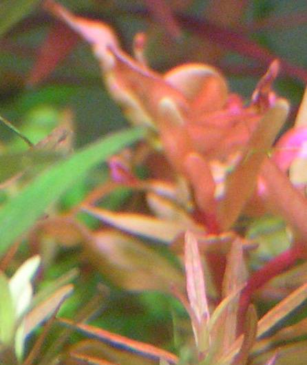

Didiplis & Araguia:
http://www.nanoplants.de/test/didiplis-araguia.jpg
Didiplis tips died and looking stgrange, Rotala Mexicana Araguia turned dark green and died.
Normally looks like this: http://nanoplants.de/plants/Rotala-M...a-araguaia.htm

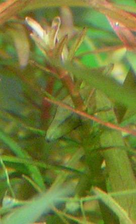

Limnophila Hippuruides:
http://www.nanoplants.de/test/limno.jpg
Gets much more sideshoots but all with small diameter & very short leafs
Normally looks like this:http://nanoplants.de/plants/Limnophila-Hippuruides.htm

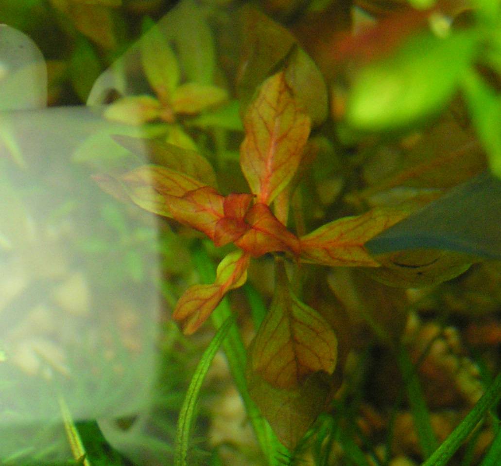

Rotala H´ra
http://www.nanoplants.de/test/hra.jpg
Get very tiny curled leafs
Normally looks like this:http://nanoplants.de/plants/hra-prevx.jpg

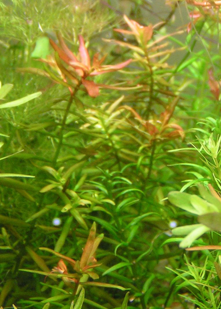

http://www.nanoplants.de/test/nesea.jpg
Nesea golden: No grow anymore, Gets curled leafs
Ludwigia Atlantis, Hygrophilia sp and Rotala Ceylon:
http://www.nanoplants.de/test/atlantis-2k.jpg
This plants were the few plants that remained looking fine.
(but even Atlantis showed a little bit curled leafs)

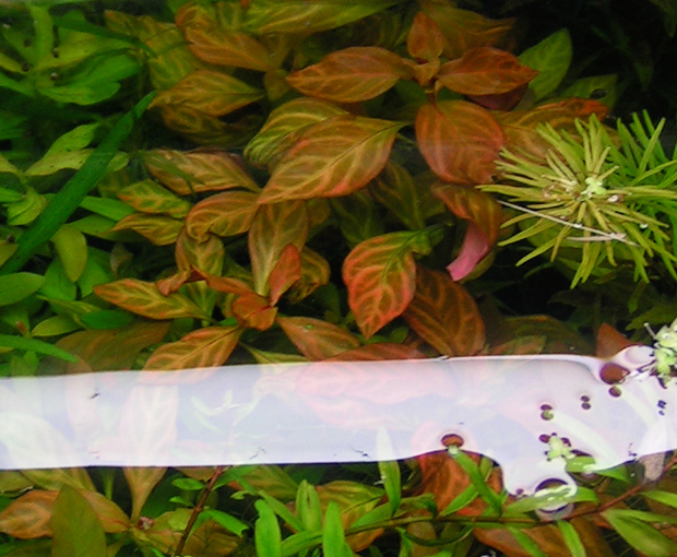

So explain this tank then, these plants are far more touchy than any listed above:
My Mg is 26 ppm and the Ca++ is 16 ppm,
Outdoor tank with Davis, CA USA tap water(52 ppm Mg, Ca++ at 33 ppm):
L cuba
You will note, I'm not just taking a pic of one individual stem top.
So this is way off in terms of a ratio for Ca/Mg.
My tanks in Sacramento Water which is much softer in terms of KH and GH: Roughly 17 ppm for Ca++ and 4 ppm for Mg.
The change you made by raising Ca++ two x does not support the hypothesis, it merely is correlation.
The ratio itself is meaningless.

So that sounds like Mg, not Ca if I were to guess, Ca recovery of tip growth supposedly takes a lot longer.
CO2 can and does change over time. What might be okay for a new planted tank and grow in phase might not be what a mature tank needs.
Something as simple as slightly hitting the regulator operating pressure and making it go from say 9 psi to 7 psi can have a profound effect.
End of the gas tank dumps seem to occur often for many folks. Dual stage regulators rule that out though.
Degassing rates change when the water level changes due to evaporation. Nano tanks have issues more than larger tanks due to this and also due to heat changes I suspect.
Most of it is simple stuff we overlook. I use sumps, so the degassing rates are very stable.
I start looking for things real quick if I see any poor growth, algae, fish, shrimp health issues etc.
Most of the time, 95%, it's something stupid I overlooked. It happens to me, it happens to Amano, you name the aquarist, it's happened to them.
Yes, I also think mg was the main problem if nearly all plants recovered quickly.
There were still a few which recover badly like Nesea Golden. It seems this plant needs for any reasons much longer to recover.
All other were doing quickly.

I had some of my CO2 tanks run out today and refilled them.
CO2 was off line for maybe a little under a day, but since I have high light, the response is rapid if there's anything wrong. The Ludwigia "red" had the most noticeable response to this:
I've seen such responses many times as I change CO2 gas tanks often on many aquariums every year. My own tanks can go through a 10lb gas tank in maybe 6-12 weeks. So I chaneg them more often than many folks. Which is to say I can see what happens when there's no CO2 and which of my plants responds negatively.
None of the other plants really cared that much except this Ludwigia.
It's one of the faster growing plants also and right under the light and in the current.
Another plant that responded a little, but not quite as much was the L. sphaerocarpa, but only a couple of tips.
The tips are the key to spotting a CO2 issue.
If another day had gone by without fixing the CO2, other species would have had similar issues or more permanent stunted tips.
These will recover, but would take a bit.
Hmm, attached is an image from my Ludwigia Red and they are sitting in my 14G Lowtech tank. And yes, they do not grow any bushy there, but for me they have "normal sized leafs" and I cant see any major problems by keeping this plant even under bad Co2 conditons.
About plants and their "real life" colours:
Yours Ludwigia pic has a little bit colour correction in it and my Ludwigia pic as well.
The second pic you see shows my Mini Butterfly "digitally untoched" in my 3Gal nano tank (24Watt HighLight).
My Butterflys look in real life exactly like seen on the image and you will never get those colours without having tons off light. So dont get fooled if you see any tank pics where any tiny plants show the most craziest red, magenta or pinkish colours under any lame stock lighning , because 90% off them are only thx. to Photoshop.
